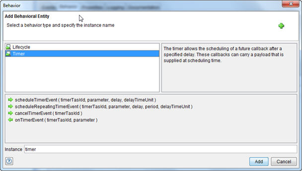

The following table describes the buttons on the upper half of the Behavior tab.
| Button | Description | ||||||||
| Add | Opens the Add Behavioral Entity dialog. The upper left side of
the Add Behavioral Entity dialog displays the available behavior-types.
The upper right side of the Add Behavioral Entity dialog displays
a description for each selected behavior-type.The
default available behavior-types are as follows:
The lower half of the Add Behavioral Entity dialog displays the available sample behaviors for the currently selected behavior type. The Instance field is used to refer to the behavioral entity in function actions. This field is optional so that you can create multiple instances of a behavior. Based on the selected behavior, a default instance name is displayed. If required, you can specify a different instance name. The following sample
behaviors are listed:
