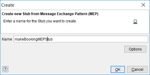

Note: If at least one stub is already created, you can right-click the Stubs folder or one of the existing stubs, and then select .The Create new Stub dialog box is displayed.
- Enter a name for the stub in the Name field.

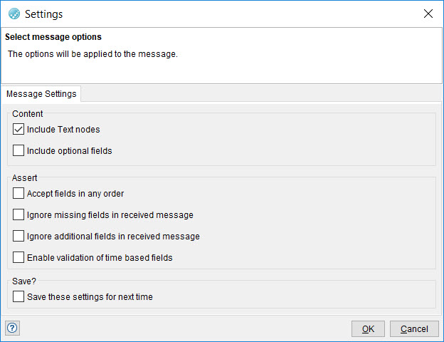

- Click Options to open the Select message
options dialog box, and enter additional settings for messages.
- Click OK.
