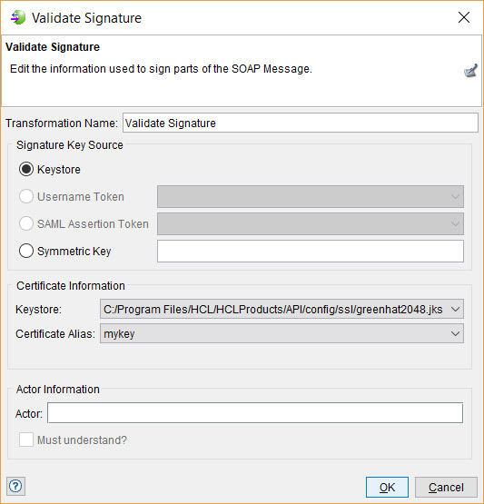

Select Validate Signature from the list.
The Validate Signature dialog box is displayed.
- Perform any of the following actions:

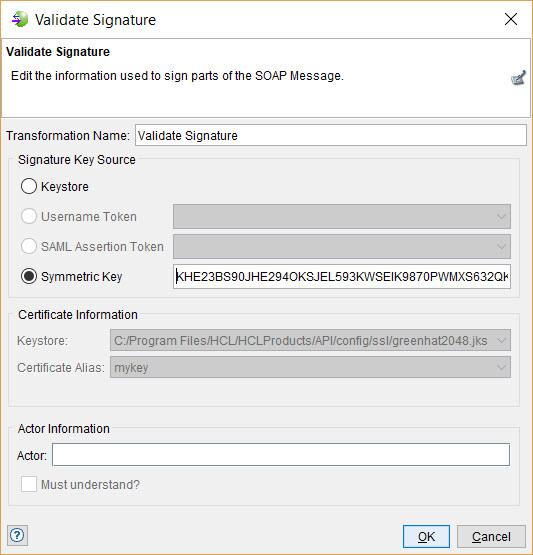

Perform the following steps to configure the validate signature action if the asymmetric
key-based signature algorithms was used to sign messages:
Perform the following steps to configure the validate signature action if the symmetric
Complete the following steps:
- Click OK to save and close the Signature dialog box.
- Click OK to save and close the Field Properties dialog box.
- Click OK to save and close the Message Editor dialog box.
