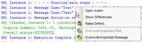

When you run a test against a stub, an entry is displayed on the stub console when a match is found. You can right click the entry for a list of options, as shown in the following illustration.
If you click Show Differences, the Message Differences window is displayed. See The Message Differences window for stubs in this topic. For the other options, see Console options in this topic.

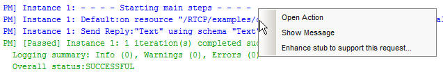

If no match is found and you have a default case (a message with a No Match guard), an entry is displayed for the default case on the stub console. You can right click the entry for a list of options, as shown in the following illustration.
If you click Show Message, the Message Differences window is displayed. See The Message Differences window for stubs in this topic. For the other options, see Console options in this topic.

The following options are available when you right click a message case or default case message in the stub console.
| Option | Case | Description |
| Open Action | Message and Default | Switches to the Test Factory perspective and opens the stub for editing. |
| Raise Defect | Message | See Creating defects in the integrated change management tool. |
| Overwrite Expected Field | Message | Replaces the value of the specified field in the stub with the value from the incoming message. This option is available when the expected message differs from the incoming message in only a single field. |
| Overwrite Expected Message | Message | Replaces the model message in the stub with the incoming message. |
| Enhance stub to support this request | Default | Adds the incoming message to the Events list in the stub. |
