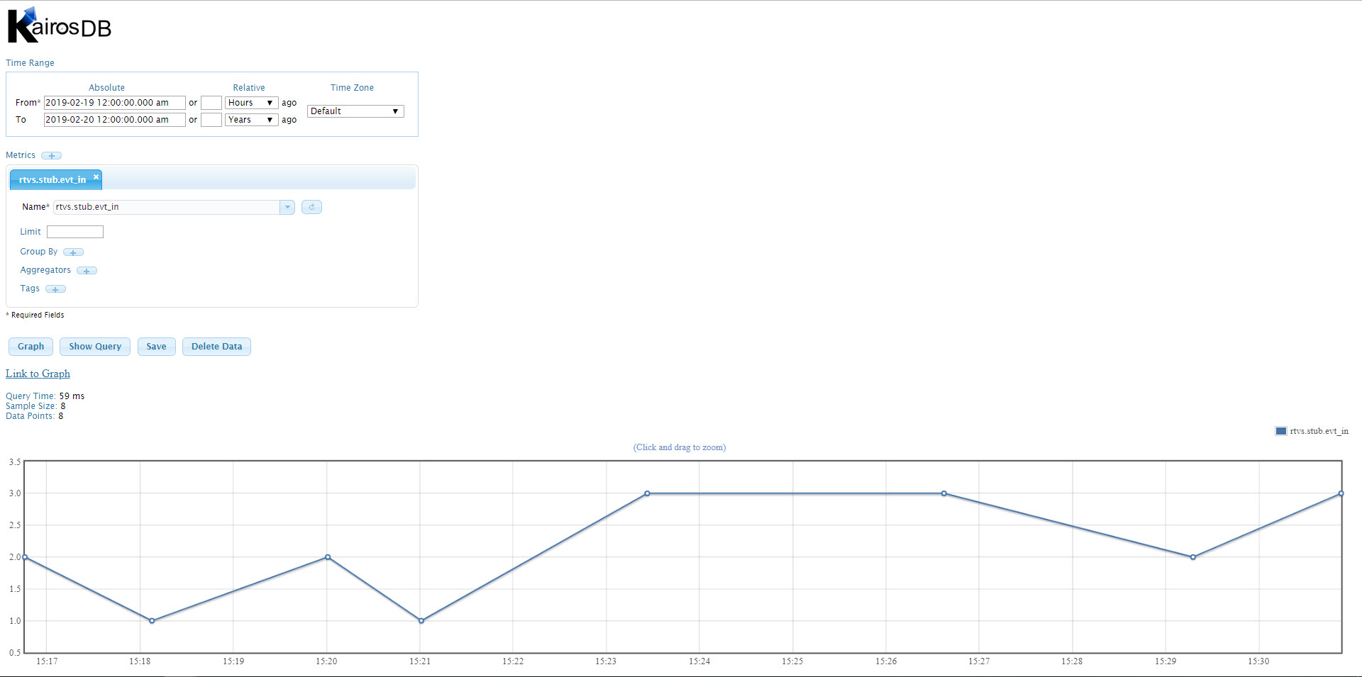

Launching the KairosDB UI
To view the query and the graph of the metrics for the stubs running on HCL Quality Server, you must launch the KairosDB UI.
You must complete the prerequisite tasks before you launch the KairosDB UI. You must use a browser on the same system that is running the HCL Quality Server instance.
Use the URL

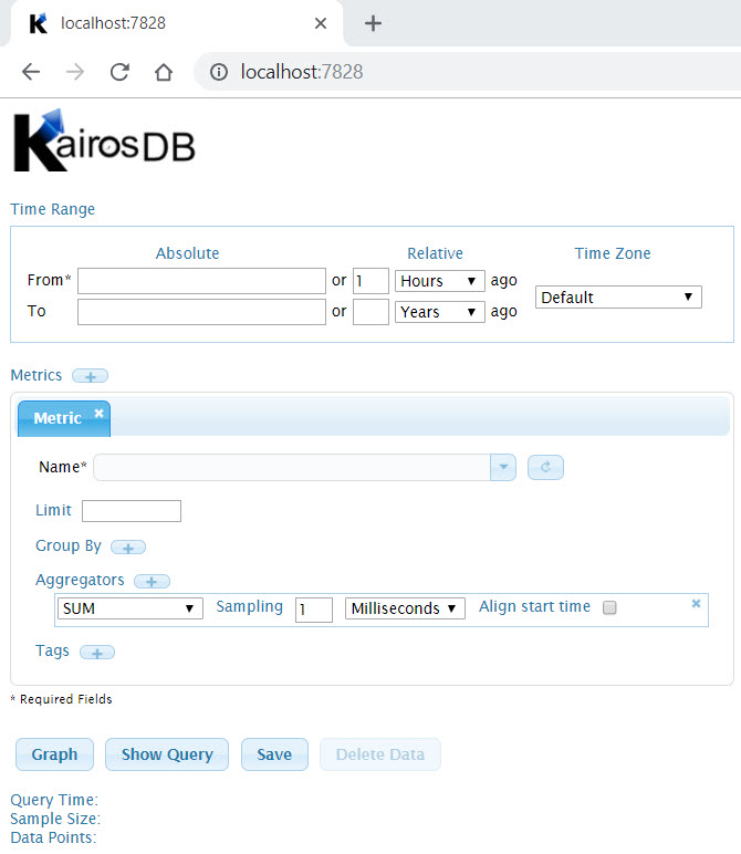

http://localhost:7828/to launch the KairosDB UI.The KairosDB UI is displayed as shown in The KairosDB UI.
Figure 1. The KairosDB UI
Note: The mandatory fields to be selected are marked with an Asterisk (*). -
Before you generate a graph for the metrics, complete the following steps:
- Select a time range.
- Select one or more metrics.
You can then view the graph for the details you specified. You can also add Tags or Aggregators to generate custom views for the data values of the metrics.
You have successfully launched the KairosDB UI. However, you must configure more settings to view the graph.

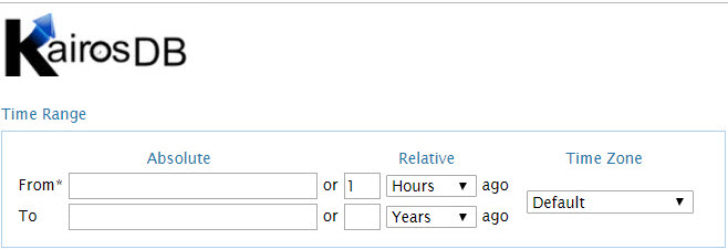

Selecting a time range and the time zone
You must first select the time range during which the KairosDB collected the metrics for the stubs. The time would correspond to the time when the stubs ran on HCL Quality Server.
You can also find the time when the stubs ran by using the Usage page accessed from HCL Quality Server. For more information, see Viewing usage statistics of virtual services in HCL Quality Server.
Launch the KairosDB UI.
See Launching the KairosDB UI. The Time Range panel in the UI is as shown in The Time Range panel.
Figure 2. The Time Range panel
In the Time Range panel, select one from the following options:
- Specify the Time Zone by selecting one from the list or let the Default time zone remain unchanged. The default time zone corresponds to the server time zone on which the HCL Quality Server runs.

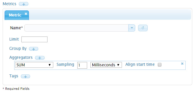

Selecting metrics
You must select metrics for the stubs you ran to include them in the KairosDB query.
You must have completed the prerequisite tasks before you launch the KairosDB UI. You must use a browser on the same system that is running the HCL Quality Server instance. You must have launched the KairosDB UI and configured the time range before you select the metrics.
From the list in the Name field, select any one metric. For example,
rtvs.stub.evt_match. See Selecting metrics in the KairosDB UI.
Figure 3. Selecting metrics in the KairosDB UI
The following metrics are supported starting from V9.2.1 onwards:- Events passed through (rtvs.stub.evt_passthrough). You must have set the pass-through configuration for the stubs. See Configuring stub pass-through behavior.
- Events that match input filters and are processed (rtvs.stub.evt_match).
- Events handled by a stub (rtvs.stub.evt_in).
- Set the number of records for which you want to view the metrics in the Limit field. For example, 100.
- You can view the graph of the metric by clicking Graph or you can proceed to view the graph after you group metrics and add aggregators to the grouped metrics.
You can add more than one metric to the query. To add a metric, click the add metric (
) icon and
complete the steps 1 and 2.

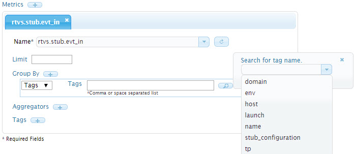

- Enter the tags you want to select for the data points in the Tags field.
You can also use the Search icon (
) and add the tags from the
list displayed for the metric. See Adding Tags to the group. Figure 7. Adding Tags to the group

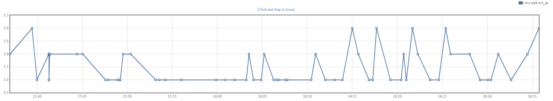

Viewing the graph
You can view the graph for the query you created using the KairosDB UI. You can view the graph at any stage of the query you are creating.
- You have set up the database to collect the data points for the stub metrics, published stubs, and ran tests in HCL OneTest™ API.
- You have launched and set the time range in the KairosDB UI.
- You have selected the metrics for which you want to view the graph.
In the KairosDB UI, click
Graph.

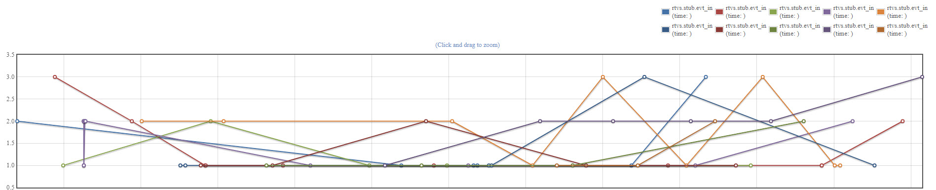

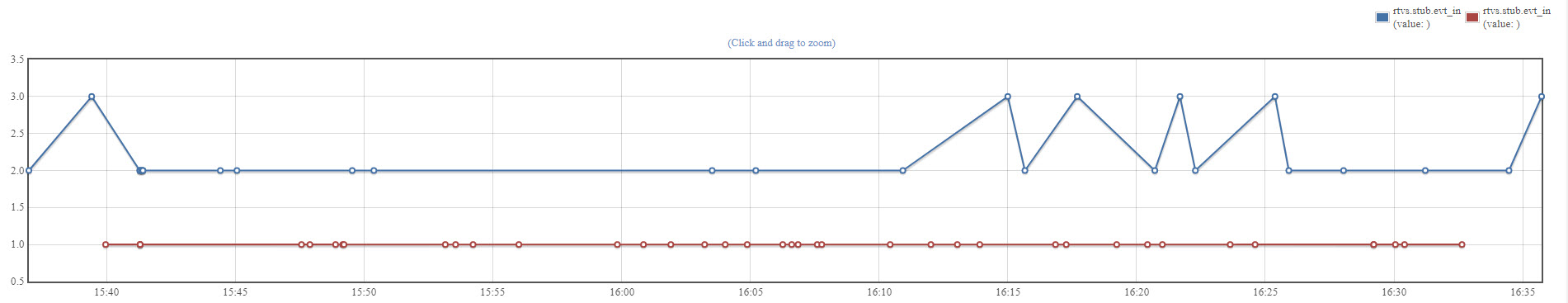

The graph shown in Graph of the stub metrics, as an example, is displayed for a query for the stub metrics in the selected time range.
Figure 19. Graph of the stub metrics

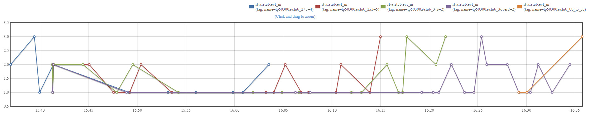

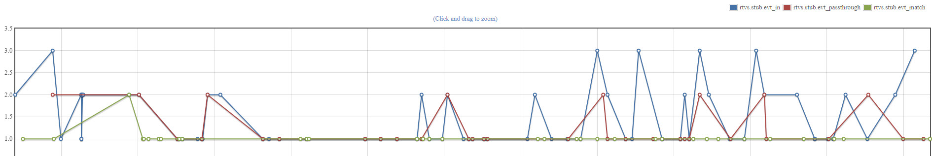

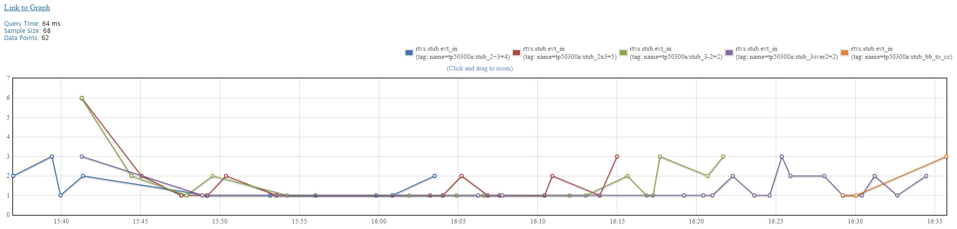

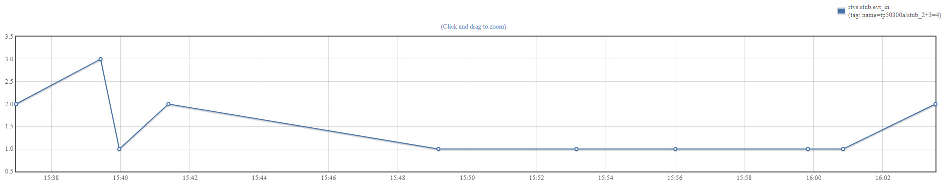

When you create a query for multiple stub metrics with one of the metrics that is grouped by
tags, and an aggregator (SUM) is assigned, and you click
Graph, the graph displays. As an example, see the graph displayed in Graph of the metrics query for such a query.
Figure 20. Graph of the metrics query

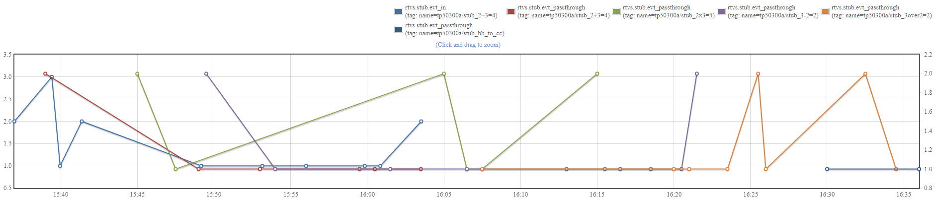

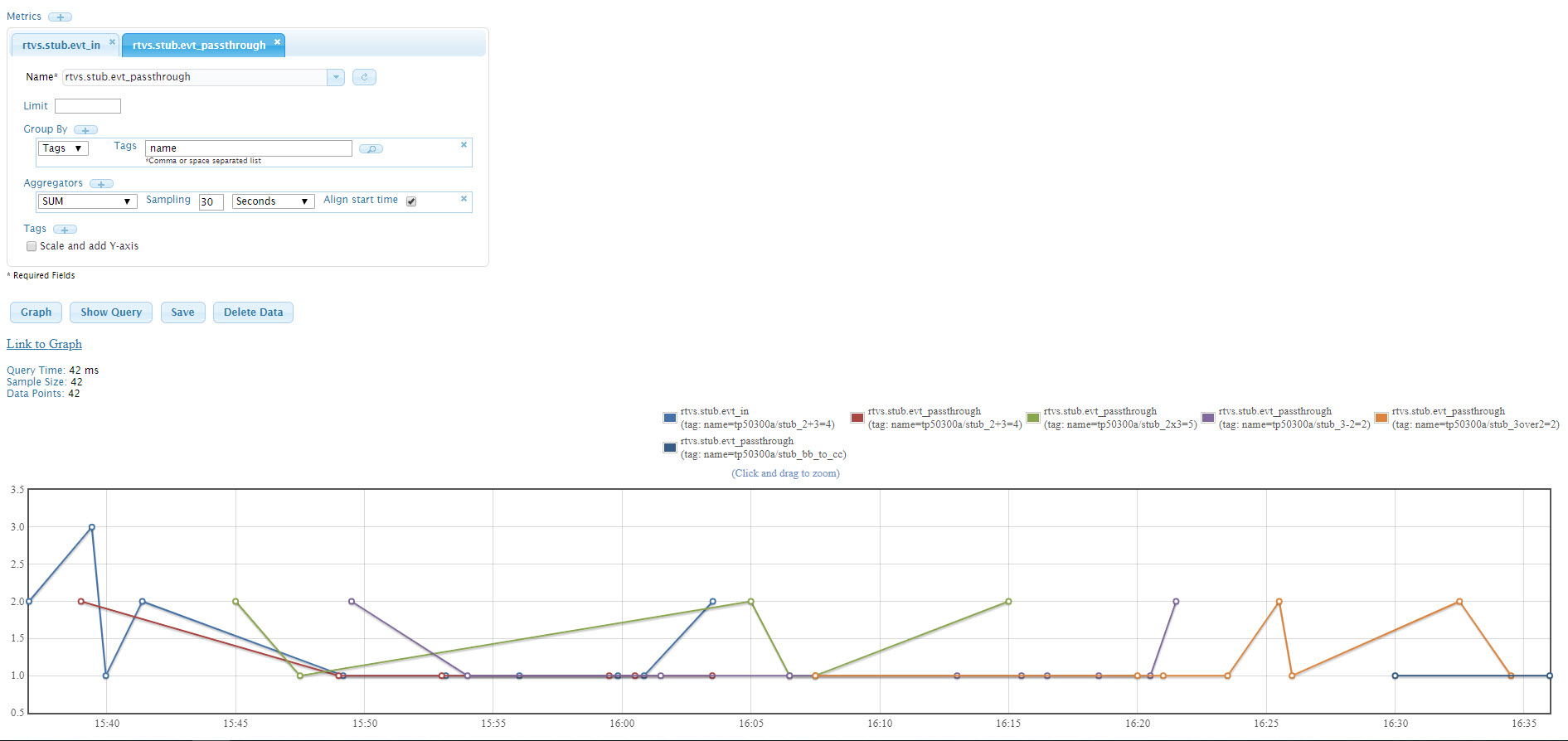

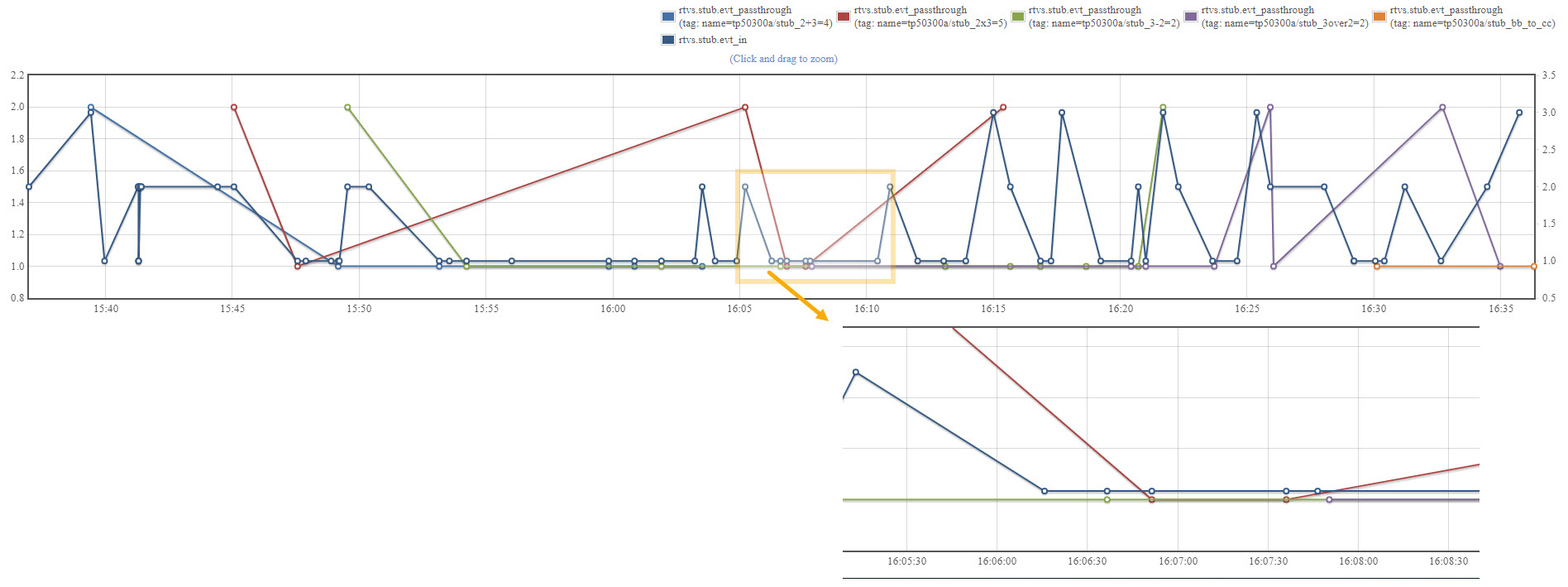

When you create a query with multiple stub metrics, the Scale and add
Y-axis field is displayed. Select this option to add the Y-axis and scale the data
series. An example graph is shown in Graph of the metrics query with scale and Y-axis added. You can compare the displayed graph to the graph in Graph of the metrics query to see how the display differs
because of the scaling and with the Y-axis added.
Figure 21. Graph of the metrics query with scale and Y-axis added
You can zoom in and enlarge part of the graph by clicking on the graph and selecting an area
you want to zoom in on as shown in View of the zoomed part in the graph.
Figure 22. View of the zoomed part in the graph

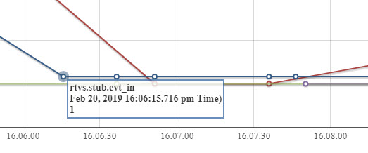

You can view the details of the data point by hovering over the data point in the graph as
shown in Hovering over a data point.
Figure 23. Hovering over a data point

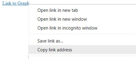

You can copy the link by right-clicking the Link to Graph link in the
KairosDBUI
and use the context menu option, Copy link address as shown in Using the context menu to copy graph link. Alternatively, you can copy the link to
the graph from the new browser window.
Figure 24. Using the context menu to copy graph link

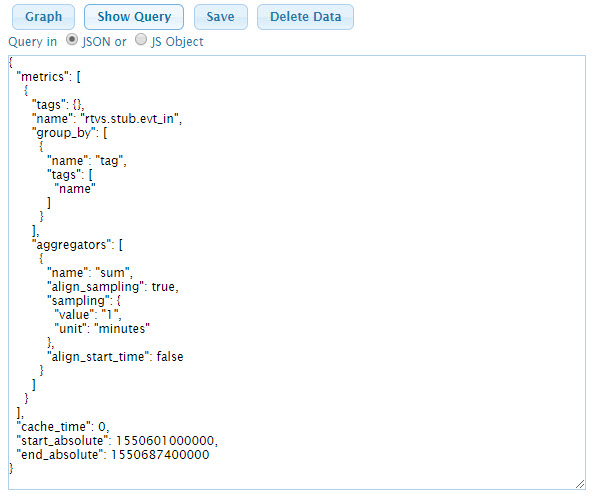

Viewing and saving the query
After you create your query by using the KairosDB UI, you can view the query and save it to the local folder that you can use later to reload the query in the KairosDB UI.
Click Show Query to view the query you created by using the KairosDB UI. You can
view the query in the JSON format or as a JS Object by selecting the appropriate button in the
displayed query.
The query is displayed as shown in the following sample.
To save the query to your local folder, click Save.
You can save the query as a CSV file or a JSON query text file by clicking the appropriate button in the dialog displayed.
- Navigate to the folder you want to save the file in, provide a name for the file, and then click Save.
You can save your query as a JSON query text file that you can use later in the HTTP requests to get the data points and their values in the HTTP response.
