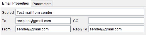

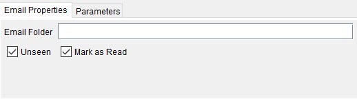

Complete the following steps in the Bindings panel:
- Click OK to save the MEP settings and exit from the Operation settings dialog box.
