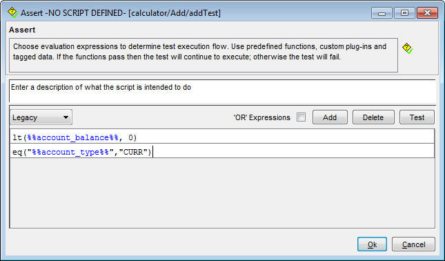

Assert
The Assert action is a conditional action that lets the user construct a list of expressions that determine whether a test proceeds. If the Assert action passes, the test continues. If the Assert action fails, the test fails and no further test actions are executed.
- ECMAScript (such as JavaScript)
- Legacy functions
- Other scripting languages (requires customization)
Expressions must evaluate to true or false. Any other result causes the test to fail with a console message that identifies the non-boolean result.
To enter an expression, click Add and type into the empty input field. To remove an expression, select it and click Delete. To test the expressions, click Test and enter temporary values for any tags shown.
For more information about list tags, see Repeating elements and list tags.
By default, multiple expressions are joined with a logical AND. This means that all expressions must pass in order for the action to pass and for the test to proceed. To join expressions with a logical OR, enable the OR Expressions option. When this option in enabled, only one of the expressions needs to pass in order for the action to pass and for the test to proceed.

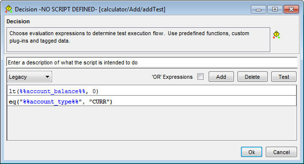

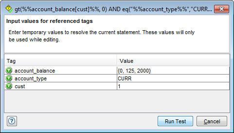

Decision
A Decision is a conditional action, the body of which is essentially a function and whose result controls test flow. A Decision can have one of two outcomes: true or false.
Any HCL OneTest™ API function can be added as an expression from the Decision editor menu (for example, simple expressions by using XPath value comparison operators, such as equals, less than). Expression arguments can be tags or literals.
- Legacy functions
Multiple expressions are processed as being joined by a logical AND. To override (that is, join them with a logical OR), enable the OR Expressions option.
To enter an expression, click Add and type it into the empty input field. To remove an expression, select it and click Delete. To test the expressions, click Test.
You can drag another action onto the branches of a Decision action. For example, to send a message to the console with information about the negative outcome of the Decision function, you can drag a Log action onto the False branch .

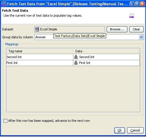

Fetch Test Data
The Fetch Test Data action can be used to map data from a test data source to existing test tags.
Click Browse to locate and select the data source from the project resource dialog. The "Group data by column" list, which is sorted alphabetically, facilitates with working with test data sets containing repeating elements. The column that uniquely defines the rows that belong to the group (usually a parent ID) must be selected.
In the Mappings section, select the data source field to map for each of the wanted tags.
If you run the Fetch Test Data option in multiple iterations, select the After this row has been mapped, advance to the next row option to map the next row of data for each subsequent iteration. If you do not select this option, each iteration reads the same row of data over and over.
- A tag must already exist that exactly matches each new column name
- The column count property must not be set
- The Auto map new columns to tags at runtime check box must be selected (the default state) in the data source editor

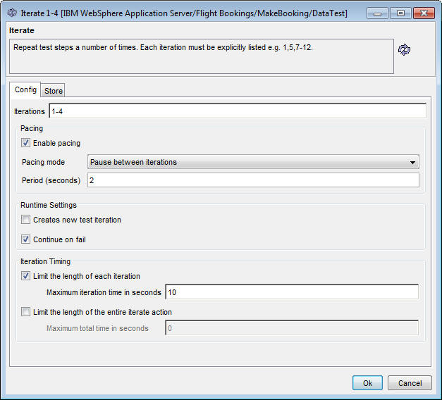

Iterate
Actions within the grouping specified by the Iterate action are run through a specified range of iterations. They can also be run while iterating over a multi-value tag.
The following options are available for configuring the action:
| Option | Description |
| Iterations | The numbers of the specific iterations to be run. For example,
if you specify "1,3", no results are stored for the second iteration
or any iterations from 4 on. You can include tags, as in the following
example:If you specify "9", HCL OneTest™ API does not run nine iterations; only the ninth iteration is run. You can also specify a multi-value tag to be processed, one value for each iteration. For more information, see Iterate through multi-value tags. |
| Pacing | The following options are available in the Pacing section:
| Runtime settings | The following options are available:
| Iteration timing | The following time limit options are available:

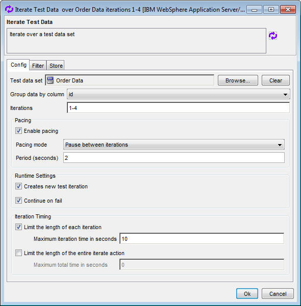

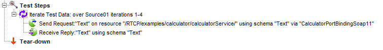

Iterate Test Data
The Iterate Test Data action, similar to the Iterate action, specifies an action or group of actions that can be executed multiple times. The number of iterations, however, is controlled by the number of filter matches found in the selected data set.
| Test data set | The data set to search. |
| Group data by column | The (optional) column within the selected data set to use as the basis for repeating elements. When used, all rows within the data set that have the same value in the "grouping" column are grouped and sorted alphabetically as repeating elements. |
example:If you specify "9", HCL OneTest™ API does not run nine iterations; only the ninth iteration is run. If you specify an iteration number that is higher than
the highest row number in your test data, one of the following results
occurs:
See also Iterate through multi-value tags in this topic. |

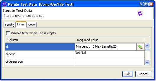

Under
the Filter tab, you can specify values to match
in columns within the data set. If no filters are specified, everything
passes the filter. Text that is entered under the Required
Value field is used as an "Equality" match by default.
To modify the filter type, click the
icon, select the appropriate filter action, and enter the
matching criteria as needed.
Only the rows that contain data that matches all filters are used. If the Disable filter when Tag is empty option is selected, the filter is not applied when an empty value ('''' or NULL) is found in the tag.
- The number of rows that match all filters
- The iteration numbers specified
Under the Store tab you can map the data in specific columns (within matching rows) to existing tags in the test.
