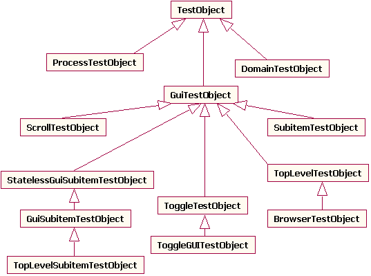

Several important subclasses extend TestObject and form the foundation of the Functional Test test framework, as shown in the following diagram:
TestObject Hierarchy
GuiTestObject is the base class for modeling all objects in the application-software-under test that have a graphical user interface (GUI). The SubitemTestObject class models the subitems that are contained in other objects, for example, lists. A ProcessTestObject is created every time Functional Test initiates an application. Functional Test models objects into groups called domains. Typically, each HTML browser has its own domain instance, as does each running Java Virtual Machine (JVM). Windows and .NET applications have a domain instance that Functional Test dynamically creates as needed or requested. The DomainTestObject class provides access to information about these domains.
Each TestObject contains a reference to its corresponding object in the application-under-test. The reference either points directly to the object or points to a uniquely identified description called a MappedTestObject. A MappedTestObject is a collection of name/value pairs that describe the properties and expected values of a component in the application-under-test. Functional Test stores these objects together to create an object map, which serves as an approximate representation of the hierarchy of objects in the application-under-test.
