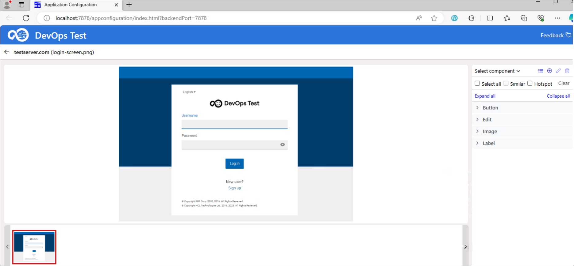

    The design images are uploaded and the identified controls on the pages are displayed.
    Application design
