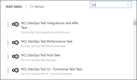

  3. Add a task to the agent job by completing the following steps:
    1. Click the Add Task icon Add Task icon in Azure DevOps pipeline for the agent job.
      The Add tasks pane is displayed.
    2. Search for the HCL tasks defined in the Test Workbench extension.
      The tasks that you can select are displayed.
      HCL Task selection in Azure DevOps
      Depending on the type of test that you have created in Test UI, you can select the type of task.
      You must use the following table to identify the task you must select:
