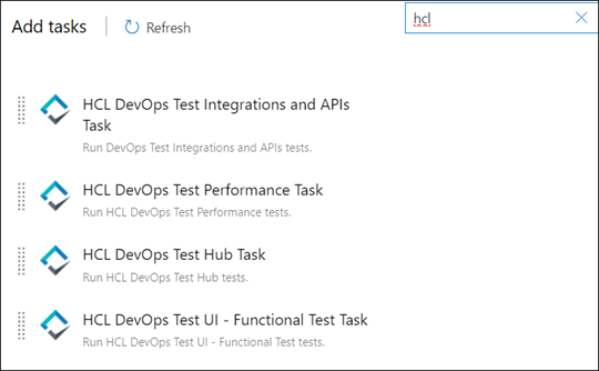

    2. Search for the HCL tasks defined in the Test Workbench extension.
      The tasks that you can select are displayed.
      HCL Task selection in Azure DevOps
      Depending on the type of test that you have created in Test UI, you can select the type of task. You must use the following table to identify the task you must select:
      Type of test Task to select
      Functional test scripts
      DevOps Test UI - Functional Test Task
    3. Select the DevOps Test UI - Functional Test Task option, and then click Add to add the task to the agent job.
