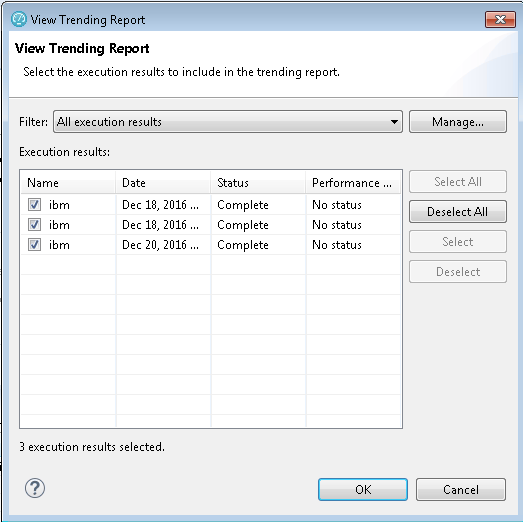

Execution Results Filters

  1. In the Test Navigator view, select the run for which to open the trend report.
  2. Right-click the run and click View Trend Report.
  3. To view the trend that is based on certain criteria, in Filter, select a filter criteria.
    If there is no customized filtering criteria, create one by clicking Manage and then Add.
  4. To save the criteria, click Save, specify a name to the filter, and click OK.
    The results in the execution results table are filtered out according to the specified criteria.
  5. Click OK.
    The trend report is generated.
