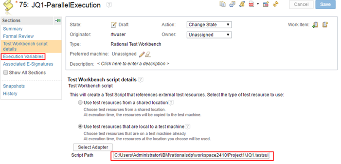

  1. Using the Test Workbench script details page of a Engineering Test Management test script, associate a Web UI test script with the Engineering Test Management script as shown below:
    Test Workbench script details in RQM test
    Be sure to specify the value in the Script Path field to be the path to the Web UI test script. For additional details, see Creating a reference to an automated test script on a local test machine.

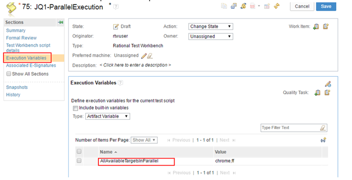

  2. To run the test on a set of browsers or on all browsers and connected mobile devices, go to the Execution Variables page of the Engineering Test Management test script and specify the execution variable to pass to the script.
    Execution variables
    1. To run the test on all available browsers and connected mobile devices, use the execution variable AllAvailableTargetsInParallel and specify the value as All.
    2. To run the test on a selected set of browsers, use the execution variable AllAvailableTargetsInParallel and specify the value as a comma-separated list of browsers, for example, chrome, ff.
    3. To run the test on a particular browser, use the execution variable RTW_WebUI_Browser_Selection and specify the browser as the value, for example, chrome.
