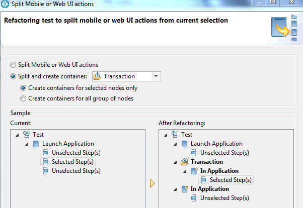

  4. In the refactoring dialog that opens, click Split and create containers. Ensure that Transaction is selected.
    Refactoring test to split mobile and web UI actions dialog
  5. To add a transaction only for the selected steps, select the Create containers for selected nodes only option.
  6. To add a transaction for all the nodes (Launch App and In App) in the test, select the Create containers for all group of nodes option.
  7. Click Finish.
    The group of steps are nested in the In App node which is also nested in a Transaction.
