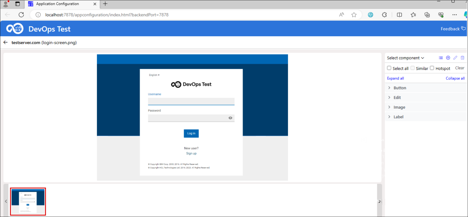

  5. Click the Design tab.
  6. Click + Add Design to upload more designs.
  7. Browse and select the .jpeg, .jpg, or .png files from your local drive, and then click Open.
  8. Click Add.
    The design images are uploaded and the identified controls on the pages are displayed.
    Application design
You have added the web application design and it is listed on the Application Configuration page.
