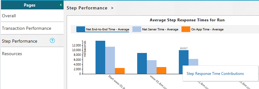

When the test is completed, the statistical report displays graphs that represent the response time for each step in the test. By default, only the 10 highest response times are collected during playback. You can modify the filter by using the context menu on the legacy report and by going to the edit mode on the web report.

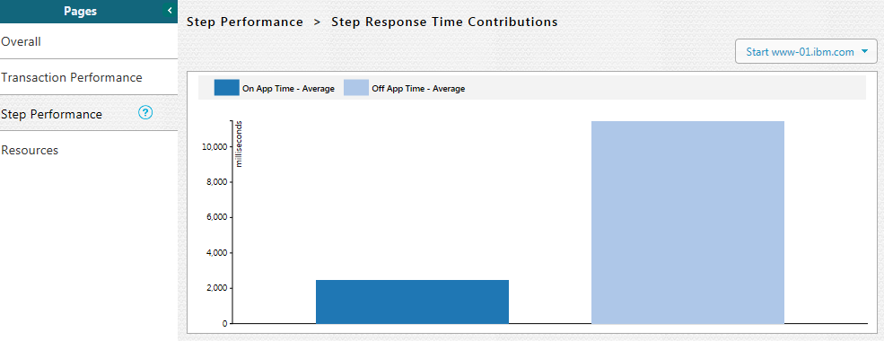

Click any response time graph and select Step Response Time
Contributions. The report displays two bars, one to show the time spent by the step on
the application (On App Time) and another to show the time spent on the
network and server (Off App Time).
Note: The Step Response Time Contributions option is available only if you played back the test with the Firefox or Chrome browser.
Figure displaying the Step Performance tab with Step Response Time Contributions context menu.
Figure displaying On App Time and Off App Time.
