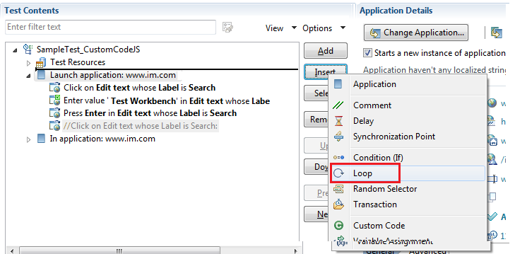

- In the Test editor, click the Launch Application or In Application node.
Click .
In the confirmation dialog, click Yes.
- In the Loop Details area, specify a name for the loop.
