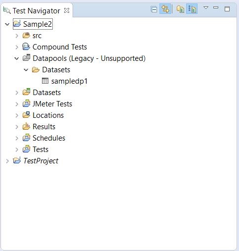

When you open the workspace earlier to 9.5 in HCL DevOps Test UI (Test UI) 9.5, the existing datapools in the workspace are stored in the Datapools (Legacy-Unsupported) folder as shown in the following figure.
legacy datapool
To convert the existing datapool to a dataset:
  1. In the Test Navigator, browse and select the existing datapool.
  2. Right-click and select Convert to Dataset…. Verify that the name of the dataset is the name of the existing datapool and format is .csv.
  3. Click Finish. The converted datapool opens in a CSV editor.
