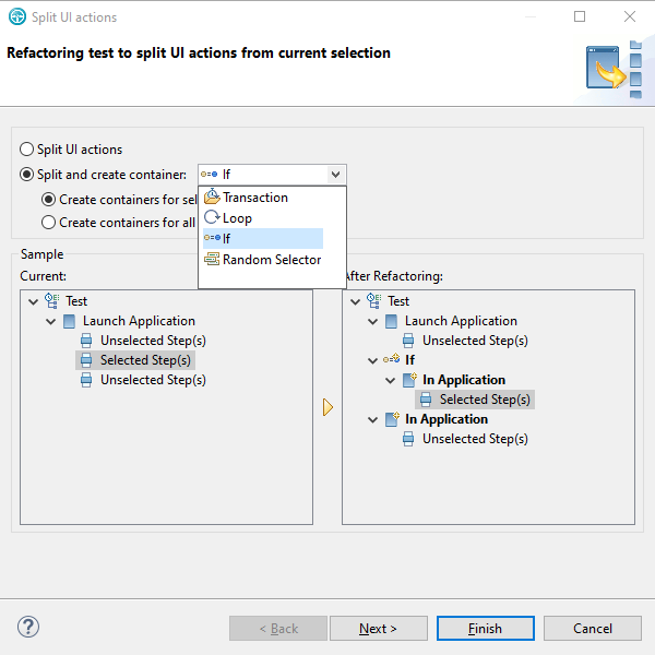

Select the steps to be added to the
Ifblock, right-click and then click Split Mobile or Web UI actions. - Select Split and create container, and then select If from the drop-down list.
Click Finish.
The selected steps along with the Launch application node are moved to theIfblock and the rest of the steps are added to the In application node. -

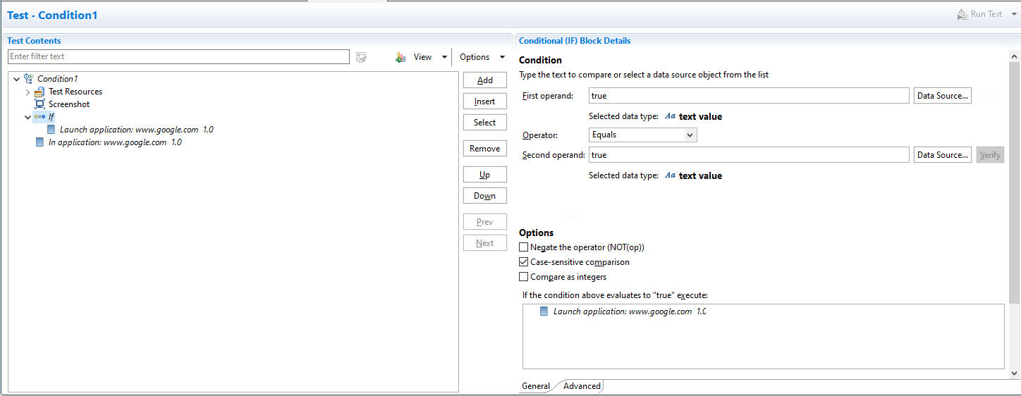

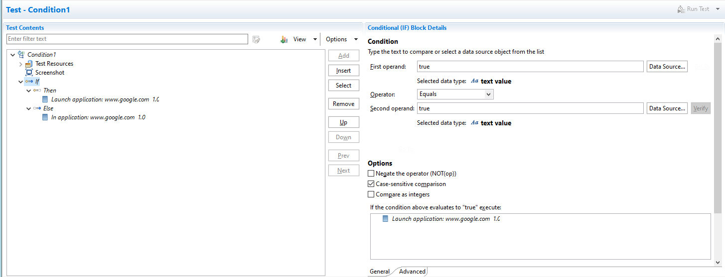

Click the
Ifblock and then click to add theElseblock.TheElseblock is created and the steps from theIfblock moves toThennode. -
Add the following conditions in the Conditional (IF) Block
Details area, under:
- Next to the First operand field, click Data Source, and then select a data source to be compared with the string in the Second operand field, or type a value in the First operand field.
- In the Operator field, indicate the basis of comparison of the two operands. Note that the two operands are strings.
- Next to the Second operand field, click Data Source, and select a data source to be compared with the First operand, or type a value in the Second operand field. When the defaults are used (both operand fields set to true and the Operator field set to Equals), the block is always processed.
Under Options, choose any of the comparison types by selecting
the checkbox:
