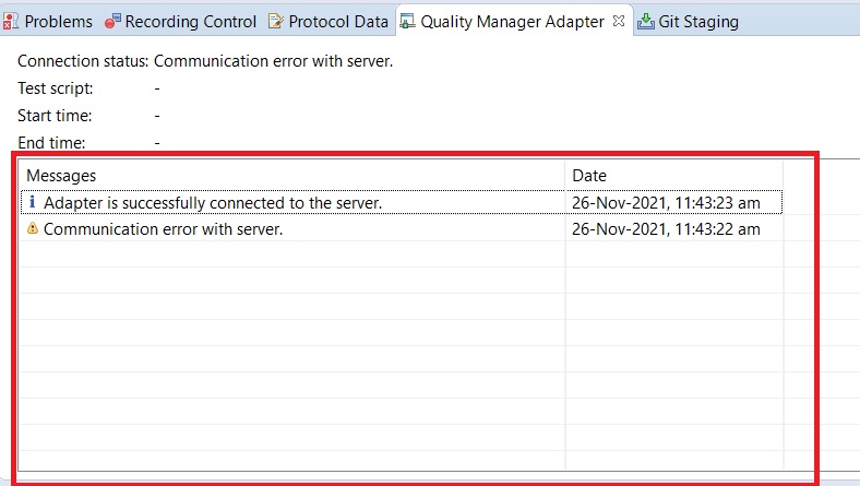

The following image displays the activities of the adapter in the Quality Manager Adapter view:

Click the Connect to RQM icon
to connect the adapter. -
Click the Disconnect from RQM icon
to disconnect the adapter.
