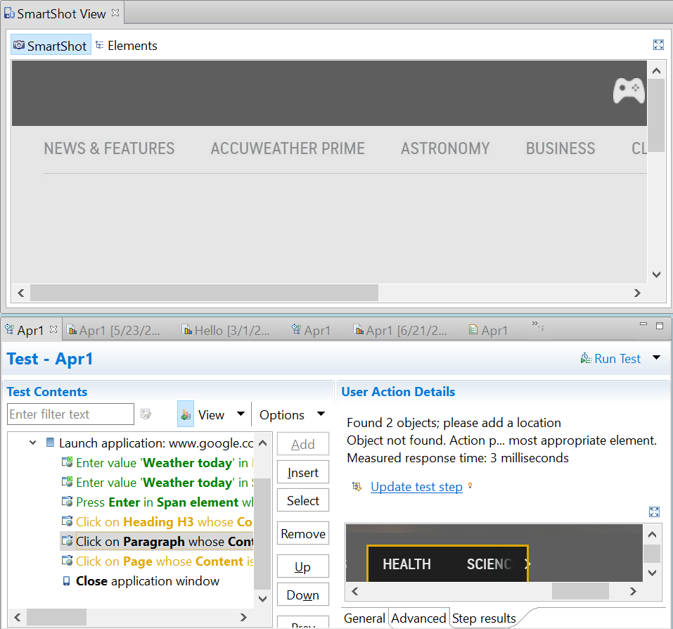

You can click a test step in the Details panel to verify whether the step is passed through the guided healing option or not. The test steps for which the guided healing is applied are indicated with the following message in the report:
Object not found. Action performed on the most appropriate element.

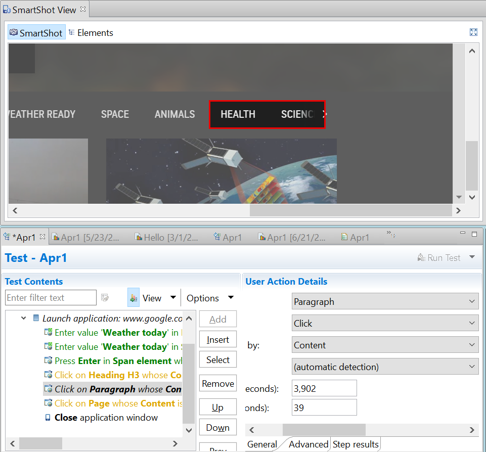

icon in the test editor to view the status of the test steps. - Click the step that is in amber color.
The snapshot that is captured during the playback is displayed in the User Action Details view under the Step results tab.
- Click Update test step to update the test.
The new captured snapshot is copied to the SmartShot View and is displayed under the SmartShot section. The snapshot includes the control that has a user action for the step.

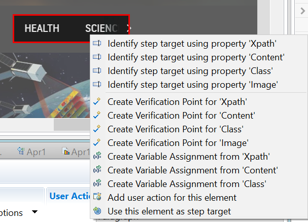

- Right-click the control and select Use this
element as step target to update the test step as shown
in the following example:
