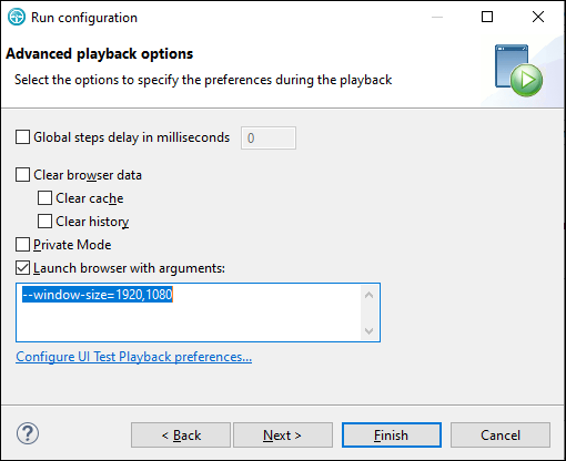

You must perform the following steps on the Run Configuration
dialog while you play back the test in Google Chrome:
- Select the options as required for the test run on the Run Configuration page.
- Click Next.
The Advanced playback options page is displayed.
- Select the Launch browser with arguments checkbox to specify the argument.
- Enter the following browser argument in the text
box:
--window-size=x,yHCL OneTest™ UI opens the browser with the specified argument and its value. For example, use the following value:
- Click Finish.
