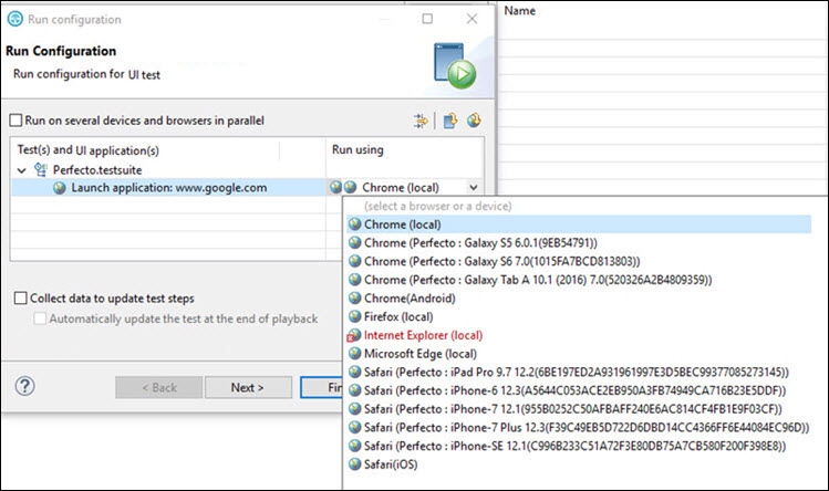

Click Run Test.
The Run Configuration dialog displays all the devices along with the name and model number that are available on the Perfecto mobile cloud.
- Select a device from the Run Using list.
Click Finish.
The Web UI test starts getting executed on the selected device on the Perfecto mobile cloud.
