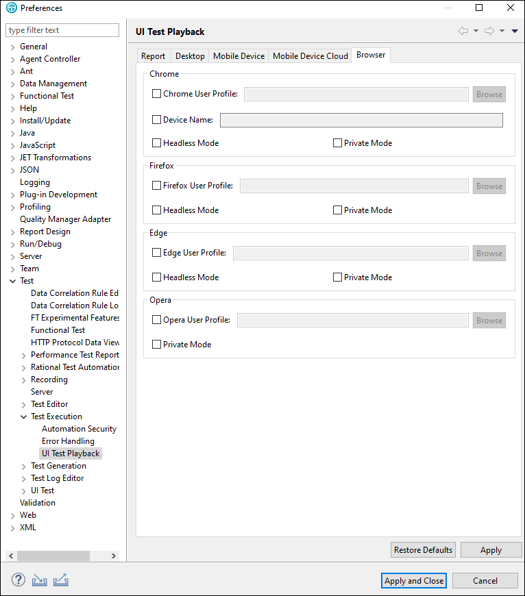

  1. Start HCL OneTest™ UI.
  2. Select Window > Preferences > Test > Test Execution > UI Test Playback.
    The Preferences dialog with the UI Test Playback page is displayed.
  3. Select the Browser tab.
    chrome_driver_error.dita
  4. Select the Device Name checkbox in the Chrome section, and then type the name of the device that you used when you recorded the test.
    For example, iPhone 6 or Galaxy S5.
    Note: Select the device from the available default list in the browser. Playback on a custom device is not supported. To see the list of devices, see Recording a test with Google Chrome Device Mode.
  5. Click Apply and Close.
