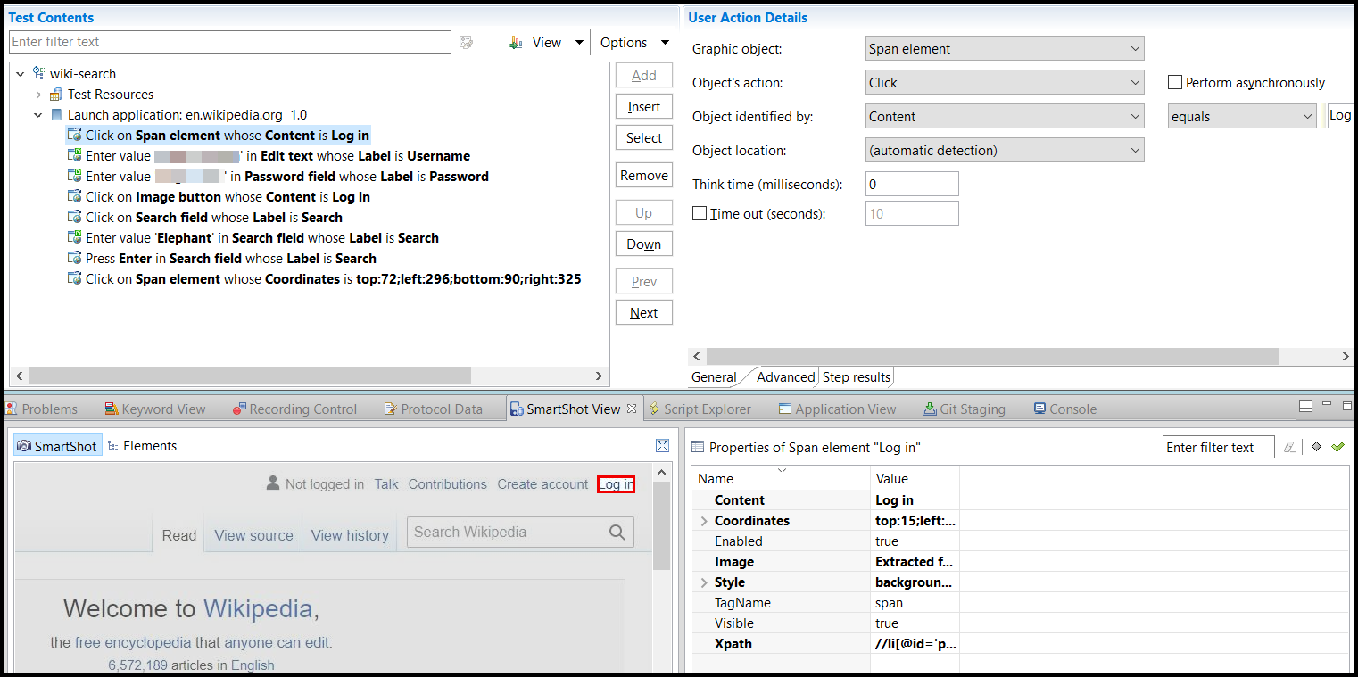

Select the test step that corresponds to the first click action that you
performed on the Log in link on the Wikipedia
website.
The screen capture and properties for the click action are displayed in the SmartShot View tab.Note: Verify whether the click action is highlighted in the screen capture that is displayed in the SmartShot subtab.

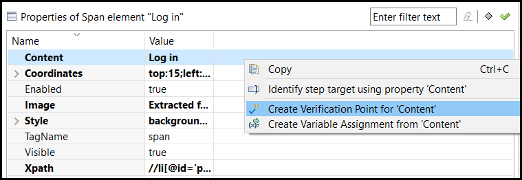

Right-click the row with Log in in the
Properties panel of the SmartShot
View tab.
Select Create verification point for ‘Content'.

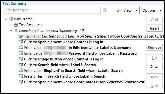

A verification point is created for the selected click action and the verification step is added in the Test Contents panel with the
icon.
- Click to save the changes.
