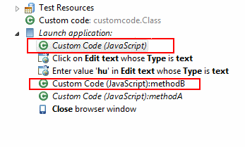

In the dialog box that opens, select a JavaScript file to be added to the test
step, click OK. It is displayed as links in Referred JavaScripts in the
definition pane. A new Test Step is added to the Test script. When a method name
is provided, the test step is named Custom Code
(JavaScript):method-name, otherwise it is named Custom
Code (JavaScript), see figure 2.
Figure 2. Custom code added as a test step in a Web UI test

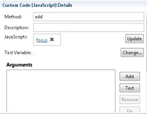

Select the step to see the JavaScript custom code definition pane that contains
the custom code details. Specify the JavaScript method name to be executed in
the Method field, and optionally provide the description.
Click the Update button to add multiple files. The
JavaScript custom code will be executed within the Web application. You can also
delete the referred JavaScript hyperlink, or click the link to open the
JavaScript file in the editor. If the JavaScript method has some parameters to
be added, specify the parameters in the Arguments field.

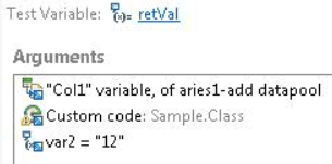

You can specify the arguments through static text, a variable reference, a
dataset reference, or a java custom code.
- To enter text values, click Text button and enter the text as argument.
- To pass test variable reference or dataset reference or JavaScript custom code return value as parameter to JavaScript method, click Add button. Select the available data source arguments, datasets, test variables or java custom code. The variable or dataset must be initially created, and a return value added. See example in figure 3.
Figure 3. Custom code details
Figure 4. Example of variable and dataset as arguments
