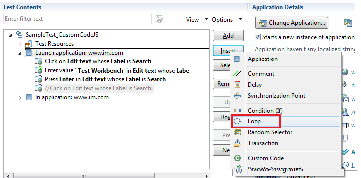

- In the Test editor, click the Launch Application or In Application node.
Click .
In the confirmation dialog box, click Yes.
