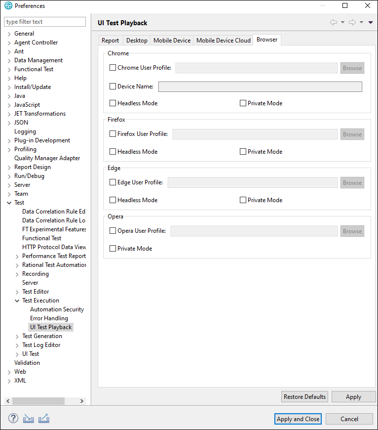

- Start HCL OneTest™ UI.
Select .
The Preferences dialog with the UI Test Playback page is displayed.
Select the Browser tab.
Select the Device Name checkbox in the
Chrome section, and then type the name of the device
that you used when you recorded the test.
For example, iPhone 6 or Galaxy S5.Note: Select the device from the available default list in the browser. Playback on a custom device is not supported. To see the list of devices, see Recording a test with Google Chrome Device Mode.
- Click Apply and Close.
Run the test.
