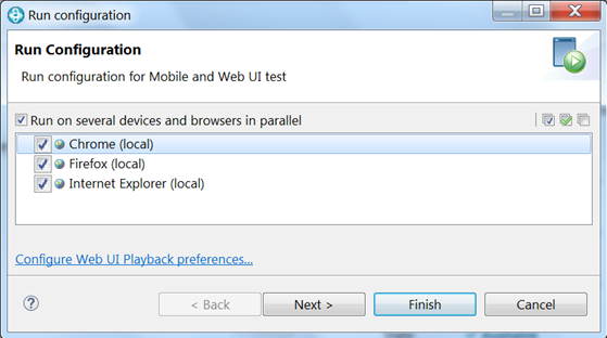

When you run a Web UI test, you can run it on multiple browsers simultaneously and thus achieve browser coverage for that test. You do this by selecting the Run on several devices and browsers in parallel check box in the Run Test wizard.
Run configuration - select browser

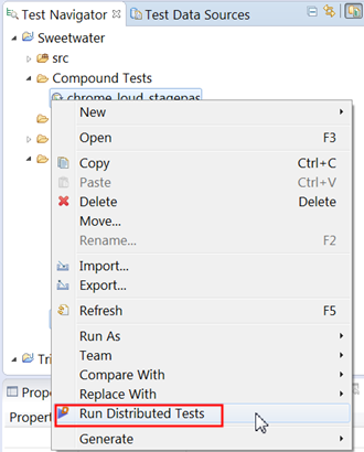

You can further accelerate the test effort by running multiple Web UI tests on multiple browsers and mobile devices simultaneously. You do this by selecting a group of tests in the Test Navigator, including Web UI tests in a compound test, and selecting Run Distributed Tests .
For instructions, see Running multiple Web UI and compound tests simultaneously.

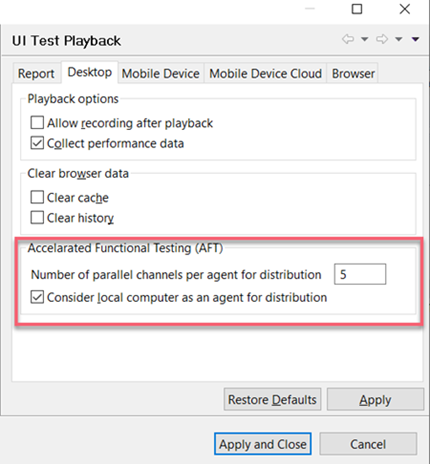

In the Web UI Playback (Desktop) Preferences (Window > Preferences > Test > Test Execution > UI Test Playback (Desktop) > Desktop), you can set the number of parallel channels for each agent computer.
Accelerated functional testing preferences
You can set the number of parallel channels to the number of virtual users (VUs) that you are licensed for or to any number that is to be associated with this feature. The default value is 5. Limit the number to no more than 15 on a computer with 4 GB of RAM. The selected Web UI tests are pre-arranged into the specified number of channels based on earlier execution times of each test, thus balancing the total execution time of each channel.
Note: If you run compound tests, the number of compound tests multiplied by the number of selected browsers must not exceed the number of channels.
