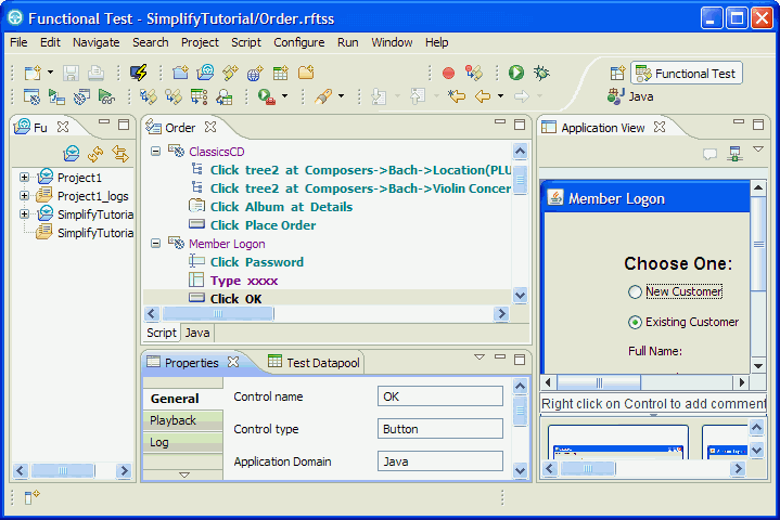

On the Recording toolbar, click Insert
Verification Point or Action Command (
In the Verification Point and Action wizard,
drag the Object Finder (
to $14.99, which is next to Sub-Total in
the ClassicsCD application.
The amount, $14.99, is outlined with a red border. - If the Select an Action page is not displayed, click Next.
- On the Select an Action page, click Perform Data Verification Point to test whether the price of the CD changes.
- Click Next.
- On the Insert Verification Point Data Command page, type Price in Verification Points Name, and click Next.
On the Verification Point Data page
toolbar, click Convert Value to dataset Reference (
) to use a dataset instead of a literal value in a verification
point. (If you cannot see Convert Value to dataset Reference on
the toolbar, make the page larger by dragging a corner of the page).
The dataset Reference Converter dialog box opens.
- In dataset Variable, type Price to replace the newVariable value as the heading in the dataset.
- Select Add value to new record in dataset to add the Price variable to the existing dataset record that you created in the previous exercise.
- Click OK.
- Click Finish.
