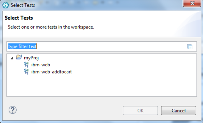

Select ibm-web and ibm-web-addtocart test scripts and click
OK.

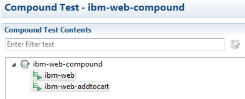

Click .
You have created a compound test that consists of two test scripts. In the next lesson, you will add a loop to the compound test so that the entire test runs three times picking one row each time.
