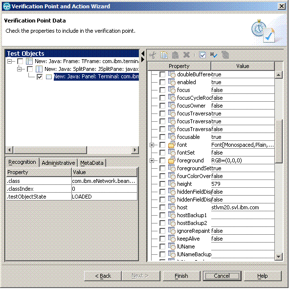

- Select the verification values to perform using Data Verification Point tab of the Perform an Action page.
- Select the required data values and properties
- Select All field properties from
the list if you are checking host field attributes. Provide a verification
point name, and click Next.The Verification Point Data page lists all the host fields from the current host screen.
The fields are named Field_row_col_text,
where row is the starting row of the field, col is the starting column
of the field and text is the text found in the field. - Optional: Clear the check box of the field
for which you do not want to perform a host-attributes check. By default
all host field attributes (except the host field names) are selected
by this verification point. If you do not want to test all host field
attributes, double-click the item in the list, and clear the attributes
in the Test Data Element list.Note: Avoid checking the name attribute of the host field in the verification point. This attribute might cause problems during script play back.
