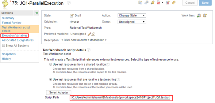

Using the Test Workbench script details page of a Rational® Quality Manager
test script, associate a Web UI test script with the Rational® Quality Manager
script as shown below:
Be sure to specify the value in the Script Path field to be the path to the Web UI test script. For additional details, see Creating a reference to an automated test script on a local test machine.

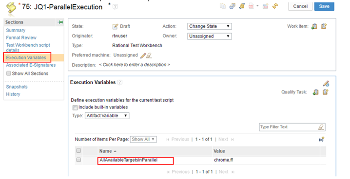

To run the test on a set of browsers or on all browsers and connected mobile devices, go to the
Execution Variables page of the Rational® Quality Manager
test script and specify the execution variable to pass to the script.
- Save the test and run it using the Rational® Quality Manager adapter.
