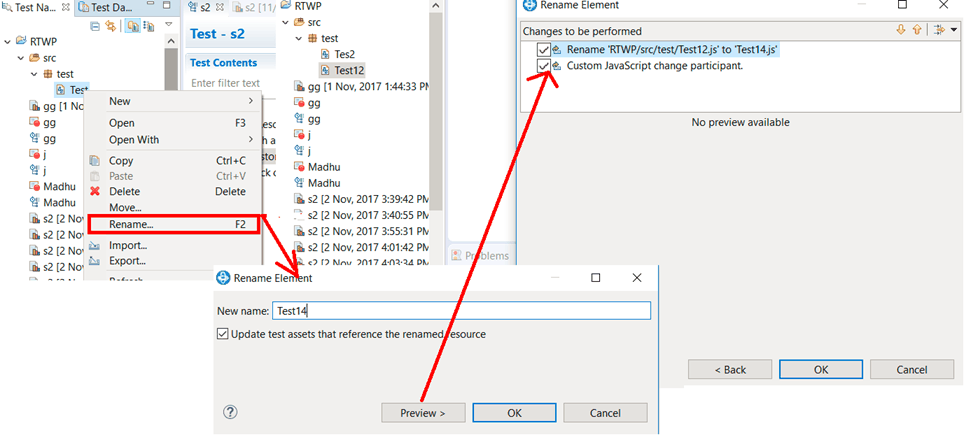

To replace a JavaScript file with a new one:
- In a project, right-click on a JavaScript file in the Test Navigator, and select Rename.
- Enter a new name in the text field of the dialog that opens.
- Select Update test Assets that reference
the renamed resource. Click Preview.
- A wizard displays all references to the JavaScript files in the project. Unselect the references that should not be updated and unselect Custom JavaScript change participant if you don't want any changes in the associated files. Click OK. A message prompts you to accept or abort the changes.
