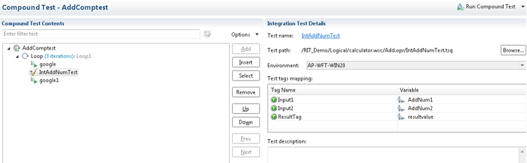

Modifying HCL OneTest™ API environments in UI Test perspective
In the compound test, you can select HCL OneTest™ API tests and change the environment of each test. The environments are set in HCL OneTest™ API, you can only change the selection from the edited compound test.
  • Open the compound editor and select a test.
  • In the HCL OneTest™ API details, you can browse and change the properties of the selected test. The Test path, the Environments and Decription are automatically updated accordingly. adding component
  • To select another environment for the Integration Tester test, use the dropdown menu.
Alternatively, you can change the environment selection for a test for a collection of tests:
  • Right-click on the tree at any level under a node in the compound test and select Replace HCL OneTest™ API Environments.
  • In the Set Invocation Tester Environments wizard, the first page displays the list of projects that use the selected environment and the number of tests from project that use this environment in the compound test. Different environments of a project
  • Select another used environment in the dropdown list. Click Finish. The new choice applies to the selected node and its children.

To map the tags in HCL OneTest™ API with variables in HCL OneTest™ UI, you must follow these steps:
  1. Click the HCL OneTest™ API test that contains the tags that you want to map.
    The HCL OneTest™ API tags are displayed in the Integration Test Details pane.
  2. Click the tag that you want to map with the variable in HCL OneTest™ UI.
  3. Click the Ellipses button inline with the tag that you want to map with a variable.
    The Variable Selection dialog box is displayed.
  4. Select the variable, and then click OK.
    The tag is mapped to the selected variable and it is displayed in the Variable column.
Note: While you map a tag in HCL OneTest™ API test to a variable in HCL OneTest™ UI, you can map only tags that contain the string value to variables. You cannot map a tag that contains multiple values to a variable in HCL OneTest™ UI.
You can add a dataset mapper in the compound test for tests that are using multiple tags. See Adding Dataset Mapper to map tags in the HCL OneTest™ API tests with the variable values of HCL OneTest™ UI.
