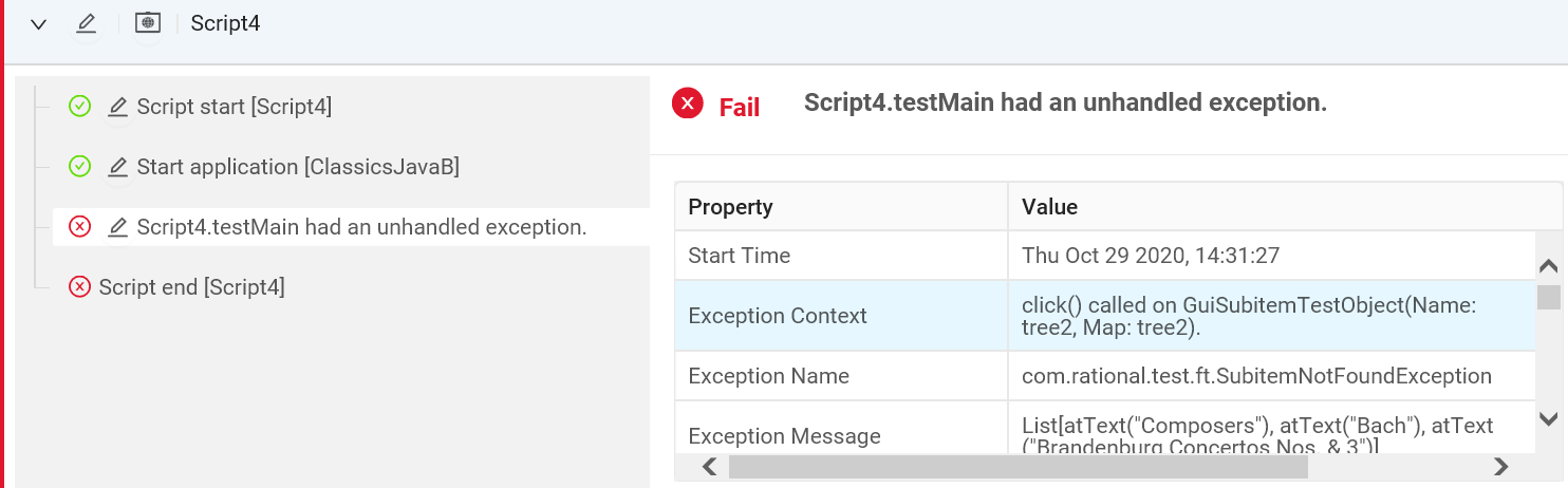

  • Expand a test by using the icon in the Details pane, to view all the passed and failed steps for each test. You can select each test step to view the details. Test steps that fail with an exception are highlighted.
    Details pane displaying an exception

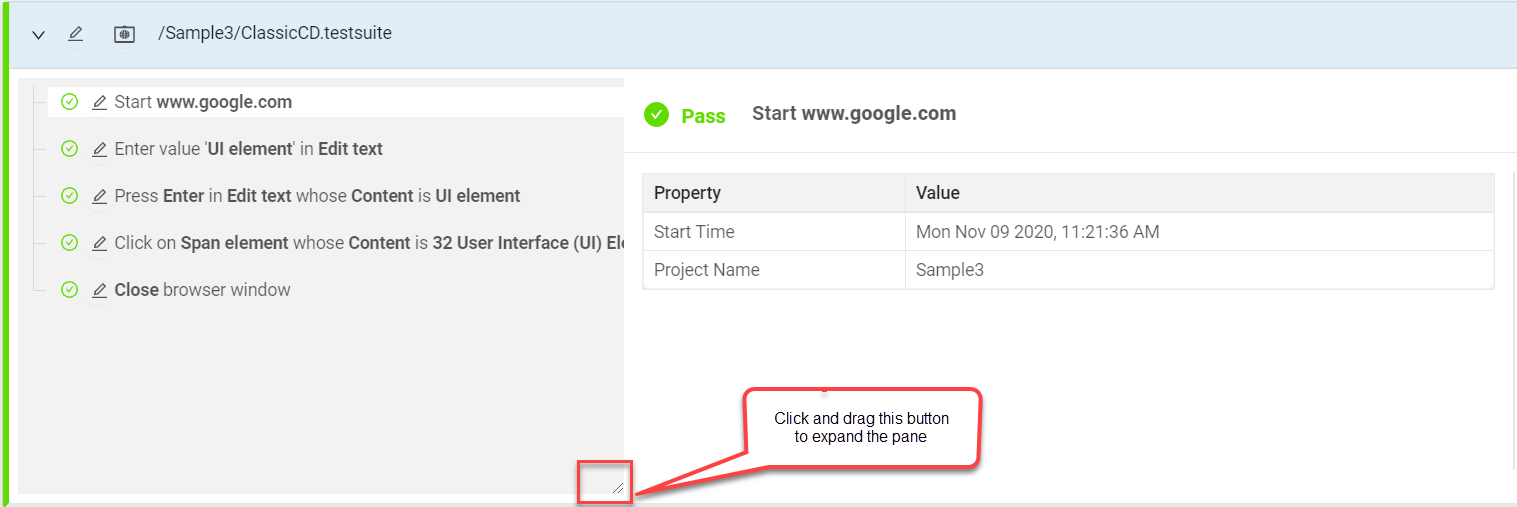

  • Click Click this icon to expand the pane that displays the test steps in the test steps pane to expand and view the complete details of test steps that have a truncated description.
    Option to expand the Details pane
Restriction: The Internet Explorer browser does not display the Resize button Click this icon to expand the pane that displays the test steps.
