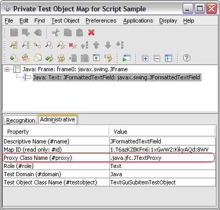

Verifying the ProxyObject that is currently being used for testing a control
You can verify the ProxyObject by recording a control using HCL OneTest™ UI. See the Administrative properties of the TestObject in the ObjectMap editor.
For example, open a Java application containing the JFormattedTextField control
and start recording. Open the ObjectMap editor to view the Administrative properties of the
TestObject representing JFormattedTextField to find the proxy that HCL OneTest™
UI is currently using to test this
control.
