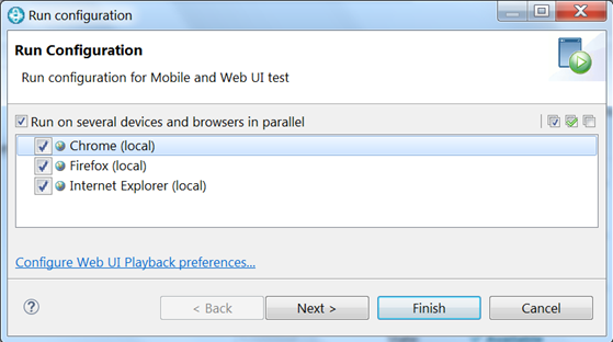

Running a Web UI test on multiple browsers simultaneously
When you run a Web UI test, you can run it on multiple browsers simultaneously and thus achieve browser coverage for that test. You do this by selecting the Run on several devices and browsers in parallel check box in the Run Test wizard.
Run configuration - select browser
