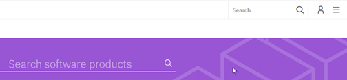

- In the browser address field, type www.ibm.com/software. This is your application under test.
Record the following use case:

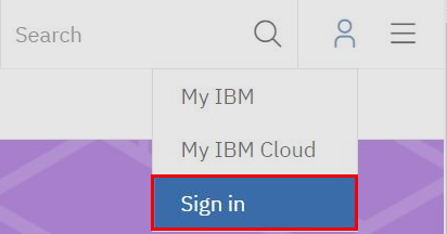

Click the person icon and click Sign in.
Enter you IBM ID credentials and click Sign in.

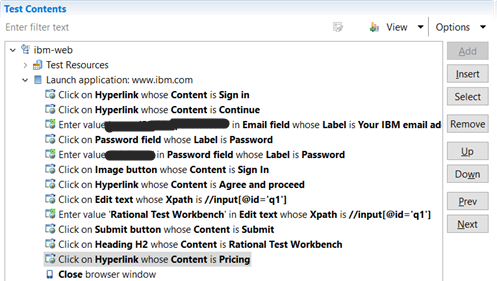

Stop the recording at this point. To stop the recording, in the Recording Control view, click
the Stop icon or close the browser window. The test is generated and the test
script would look like this:
