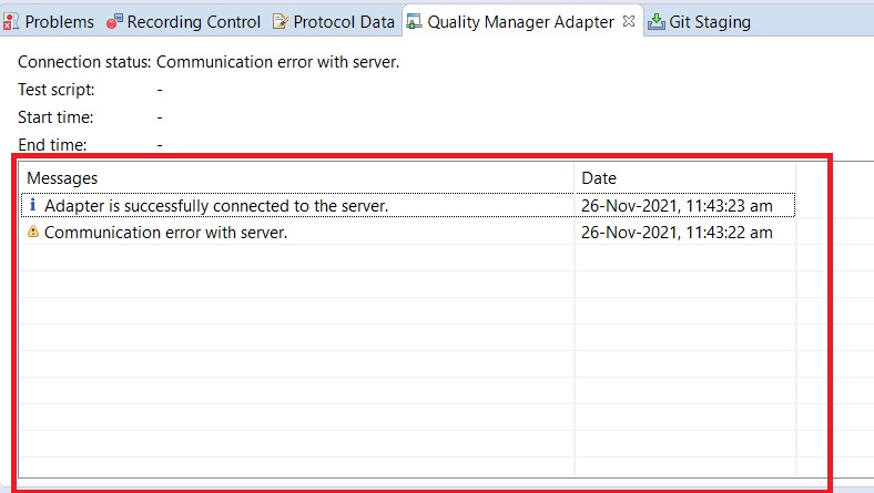

Push buttons to connect and disconnect to the Engineering Test Management server are located in the upper-right corner of Quality Manager Adapter view. This view also has a local preferences menu that you can use to control some behavior of the GUI mode adapter. If you see errors or warnings, use the Error Log view for further investigation.
The following image displays the activities of the adapter in the Quality Manager Adapter view:
