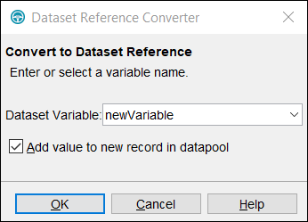

On the Verification Point Data page toolbar, click Convert
Value to dataset Reference (
) to use a dataset instead of a literal value in a verification
point. (If you cannot see the Convert Value to dataset
Reference button on the toolbar, make the page larger
by dragging a corner of the page).
The dataset Reference Converter dialog box opens.
- In the dataset Variable field, type Price to replace the newVariable for the heading in the dataset.
- Select the Add value to new record in dataset check box to add the Price to the existing dataset record you created in the previous exercise.
- Click OK.
- Click Finish.
