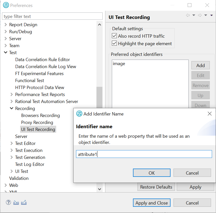

- In the test editor, click
- Click Add and in the dialog that opens, enter a name for the web object property so that it can be used as an object identifier when the test is recorded and run. Then, click OK
Use Up and Down buttons to prioritize the
attributes in the list. Click Apply and
OK

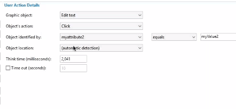

Open the test script, and check that the attributes are available in the list of
properties in Object identified by.

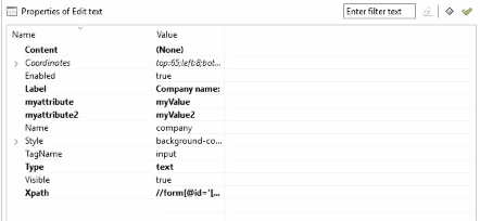

Now, the custom attributes are automatically recognized when recording the test, they are listed as main object identifiers in Object identified by and in bold, in the table of properties. You can modify the property and its value on the test steps as for the standard attributes.
