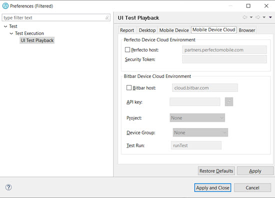

- To check the connection between the application and mobile device cloud, click .
- To enter the details of the Perfecto mobile cloud, select the Device Cloud Host check box.
- In the Device Cloud Host box, enter the host name.
Enter your credentials in the Username and
Password boxes.
- To check the connection, click Validate.
The credentials are validated and a message is displayed about the connection
validity.

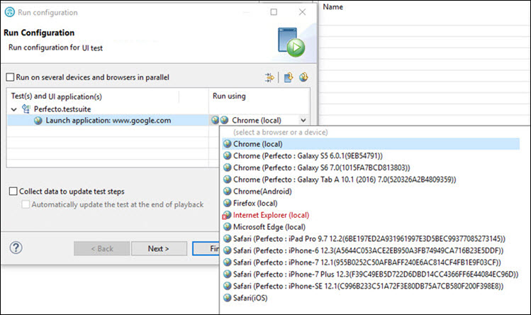

After you check the connection, run the Web UI test. To run the test, click Run
Test. The Run Configuration dialog opens.
The Run Configuration dialog displays all the devices along with the name and model number that are available on the Perfecto mobile cloud.
Select a device from the Run Using list and click
Finish.
The Web UI test starts getting executed on the selected device on the Perfecto mobile cloud.
