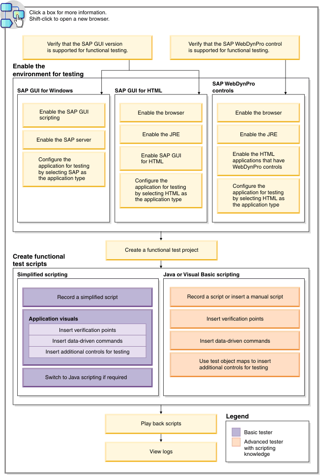

Task flow: Testing SAP applications
The diagram in this topic shows the task flow for testing the SAP application using HCL OneTest™ UI.
Although the diagram implies that each task is completed sequentially, you can do many of the tasks at the same time.
The diagram shows the task flow for testing Java applications using HCL OneTest™ UI.
Testing
SAP applications using HCL OneTest UI task flowClick this area to get information about the supported SAP GUI version for functional testingClick this area to get information about the supported SAP WebDynPro controls for functional testingClick this area to get information about enabling the SAP GUI scriptingClick this area to get information about enabling the SAP serverClick this area to get information about configuring the application for testingClick this area to get information about enabling the browserClick this area to get information about enabling the JREClick this area to get information about configuring the application for testingClick this area to get information about enabling the browserClick this area to get information about enabling the JREClick this area to get information about enabling the applications with WebDynPro controlsClick this area to get information about configuring the application for testingClick this area to get information about creating a functional test projectClick this area to get information about recording a simplified scriptClick this area to get information about inserting verification points using the application visualsClick this area to get information about inserting a data-driven commands into a scripts by using an application visualClick this area to get information about inserting an application control into the script by using an application visualClick this area to get information about switching to Java scriptingClick this area to get information about recording a Java test scriptClick this area to get information about inserting verification pointsClick this area to get information about inserting data driven commandsClick this area to get information about using test object maps to insert additional controls to the scriptClick this area to get information about running the scriptsClick this area to get information about viewing functional test results in the logs
Basic tester: A basic tester can record functional test scripts that are generated as simplified test scripts. The tester does not require programming knowledge to edit the functional test scripts. The tester can switch to Java scripting, and use the Insert Java Code Snippet or Insert Java Method features that are available in the simplified script editor. The tester then starts to work with the Java test script directly. You can use the application visuals to insert verification points, data-driven commands, and additional controls for testing.
Advanced tester with scripting knowledge: A tester with Java or Visual Basic programming knowledge can either record functional test scripts or create the test scripts manually. You can use the test object maps to update the objects and insert additional objects for testing.
