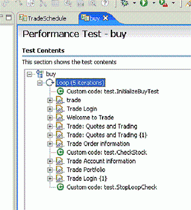

The test begins with a recording of a stock purchase transaction, using dataset substitution for the login IDs. The pages are wrapped in a five-iteration loop, as shown in the following figure:
Notice that among the various pages of the test, three items of custom code exist (indicated by the green circles with "C"s in them). This example explores these items of custom code.

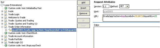

Then a randomly generated stock string is created. The value is stored as the variable stock, and is passed back as the return value for the method. This return value is used as a substitute in a request later, as shown in the following figure:
The highlighted item uses a substitution (s%3A716),
which is the value returned by the InitializeBuyTest custom
code item. We are using custom code to drive the direction of our
test.

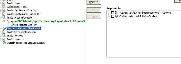

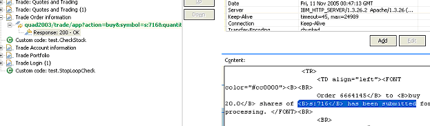

}This code begins by extracting two arguments that have been passed to the code. A part of the response in the original recording is highlighted and used as a reference, as shown in the following figure.
Some string manipulation is needed to acquire the text of interest;
in this case, the name of the stock that was actually purchased. This
newly created reference is then passed into CheckStock as
an argument, as shown in the following figure:
Note that the return value of InitializeBuyTest is
passed in as an argument as well.
The CheckStock custom code item uses these values
to verify that the randomly chosen stock generated by InitializeBuyTest is
actually purchased during the execution of the test.
