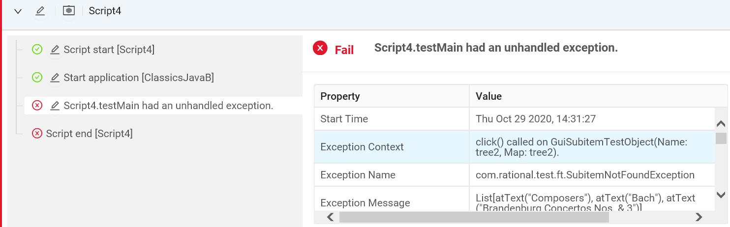

  • Expand a test by using the icon in the Details pane, to view all the passed and failed steps for each test. You can select each test step to view the details. Test steps that fail with an exception are highlighted.
    Details pane displaying an exception

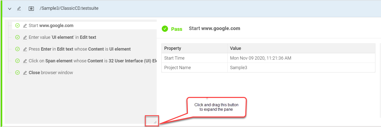

  • Use the resize Click this icon to expand the pane that displays the test steps icon in the test steps pane to expand and view the complete details of test steps that have a truncated description.
    Option to expand the Details pane
Restriction: This option is not available, if you use Internet Explorer to view the unified reports.
