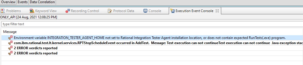

If the variable is not set, you will get a test log with error message when the compound test is run. Error message when the environment variable is not set
