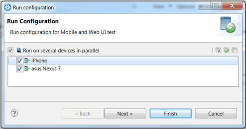

- Open the test. In the test editor, click Run Test.
In the Run configuration wizard,
select Run on several devices in parallel.
Select the devices and emulators that should run the test and click
Next.
Make sure that the devices are connected to HCL OneTest™ UI and set to passive mode. You can select all devices to run the test, all ready devices (those that are already connected to HCL OneTest™ UI), or select devices individually. You will need to configure the devices that are not connected. For more details, see Configuring the mobile test client.
