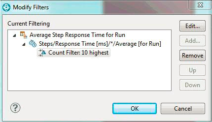

- Right-click anywhere on the Step performance report, and select Modify Filters in the context menu. In Modify Filters, select Count Filter: 10 highest (see figure 1) and click Edit.
- In the Performance Counter Filter wizard, select Filter by count. You can enter a new value in Number to Display, and select Show highest values or Show lowest values. For example, if you enter 15, the report will show the 15 highest response times or the 15 response times with the lowest values.
Figure 1: Modify Filters

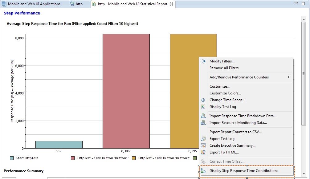

Right-click any response time graph and, from the pop-up
menu, select Display Step Response Time Contributions (see

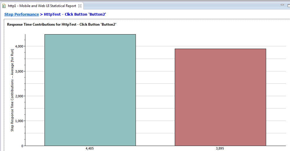

figure 2). A graph displays the time spent in the application On
App Time, and another graph displays the time spent outside
the application (in the network and server) Off App Time (see
figure 3). If you do not select Collect Response Time Contribution

Figure 2: Response time contribution bar graphs for the 10 highest steps of the test
Figure 3: On App and Off App Time for one selected step
