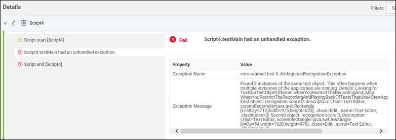

  • When you expand a test by using the icon in the Details pane, you can view all the passed and failed steps for each test. You can select each test step to view the details. Test steps that fail with an exception are highlighted.
    Details pane displaying an exception

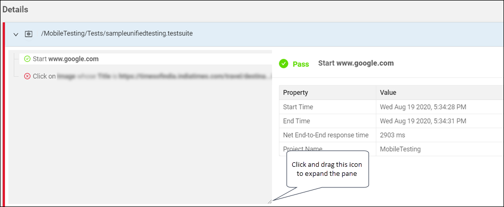

  • You can use the resize icon Click this icon to expand the pane that displays the test steps in the test steps pane to expand and view the complete details of test steps that have a truncated description.
    Option to expand the Details pane
Note: The option to view the complete description of test steps by using the resize icon is not available if you use Internet Explorer to view the unified reports
